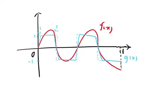

If we remove the restriction that $g$ is continuous, then this statement is trivial, as we can simply let $g = \sgn \circ f$. Then $f(x)g(x) = |f(x)|$ $\forall x \in [0,1]$. To adhere to the restriction, my idea is to construct a sequence of functions $g_n$ such that as $n \to \infty$, $g_n$ "looks more and more similar" to $\sgn \circ f$. The following is an illustration of my idea: enter image description here As one can see, $g$ behaves similar to $\sgn \circ f$, but when it is $\epsilon$ away from a zero point, it connects to the zero point linearly so to make it continuous. It's also clear that $\|g_n\|_\infty = 1$, unless $f \equiv 0$, in which then it is a trivial case. My idea is to let $\epsilon = \frac{1}{n}$, for each $g_n$, and show that: $$ \lim_{n \to \infty} \int_0^1 f(x)g_n(x) \d{x} = \int_0^1 |f(x)| \d{x} $$ The following is my attempt to formulate a rigorous construction of $g_n$:

  • A piecewise linear interpolation of $g(x) = sgn (f(x))$ won't really work, since by the constraints of your problem, the approximations $h_{\epsilon}$ will fail to be differentiable everywhere. The standard approach to these kinds of things is to define the approximation $h_\epsilon$ via mollification: see https://en.wikipedia.org/wiki/Mollifier – A Blumenthal Jan 30 '20 at 03:08
  • for C1-ness, I think you have to smoothing your $g_n$. (in fact it was not differentiable in certain points.) For $ \lim_{n \to \infty} \int_0^1 f(x)g_n(x) d{x} = \int_0^1 |f(x)| d{x} $ You can deal integral with only the set where $h_{\frac{1}{n}}$ has the value -1 or 1, since $f(x)g_n(x)$ is always positive – needmoremath Jan 30 '20 at 03:09
  • @ClementYung In the original formulation of your problem, the supremum is taken only over $g \in C^1[0,1]$. – A Blumenthal Jan 30 '20 at 03:11
  • Apologies to both, I meant $C[0,1]$. – Clement Yung Jan 30 '20 at 03:11
  • Well, you're not far off from a proof if the zero set $f(x) = 0$ is finite. But that doesn't have to be the case- it's easy to construct ugly continuous functions with countably many discrete zeroes (actually, typical Brownian paths satisfy this property). Then it's more of a pain to work with the $h_\epsilon$ as you've defined it...Using a mollification argument would certainly be simpler. – A Blumenthal Jan 30 '20 at 03:20
