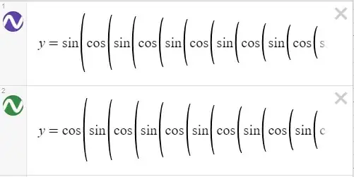

I realise that the examples so far are fairly identical, always producing graphs of $x$ to a positive even number so that as $n\to\infty$ they are the same square bottomed curve in the positive $f(x)$ portion of the plane. However, what I'm more interested in would be repeating a function like $$\sin(\sin(\sin(...\sin(\sin(x))...)))$$ or something which oscillates like $$\sin(\cos(\sin(\cos(...\sin(\cos(x))...))))$$ which can be denoted as $f(x)=\sin(\cos(x))$ and then adopt the iteration notation of $f^{\,n}(x)$ where $f^{\,2}(x)=f(f(x))$ and so on with $n\to\infty$

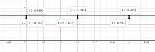

I plotted the oscillating version of this repeated function for starting with $\mathrm{sine}$ or starting with $\mathrm{cosine}$ for several iterations and obtained the following results: Functions Graphs As you cans see, after several iterations they are barely sinusoidal in nature at all and are closer to a straight line parallel to the $x$-axis, although there's barely just still some peaks and troughs (some have been highlighted). Is there any reason why they seem to approximate two numbers, namely $y\approx0.695$ for the purple graph and $y\approx0.768$ for the green graph? Is it possible to know these numbers exactly if we could perform the oscillation of functions many many times and solve?

The case of $f(x)=\cos x$ leads you to the constant function $f(x)=d$ as $n$ approaches infinity, where $d$ is the fixed point $\cos d=d $, known as Dottie's number (Wikipedia) (Mathworld) (Question 46934). This value is a global attractor, so all $x\in\mathbb{R}$ are mapped towards it when $f$ is iterated. The property holds true for related constants when $\cos$ and $\sin$ are applied one after another. In the case of $f(x)=\sin x$, $f^n(x)$ simply approaches $0$ as $n$ approaches $\infty$.

Whether this satisfies the criteria for knowing the constant will be subjective. It is very likely that similar properties hold true for the fixed points $x=\sin(\cos x)$ and $x=\cos(\sin x)$.
