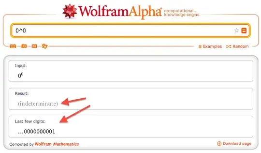

Can anybody explain how this comes about?

  • +1 Thanks! I put the top arrow in there inadvertently, and, as a fortunate consequence, learned a few things. However, the question is really about the $...0000000001$ bit. :) – Řídící Apr 05 '13 at 21:35

In my personal opinion I guess it is a joke and that last few digits and stands for $$00000000\dots 00001$$

It's a bit funny that Wolfram Alpha doesn't reproduce this one here
Wolfram Alpha calculates "last few digits" if you input large numbers such as 12^12^12, but not if you input a small number such as 2^2^2. I think it simply preemptively mistakes 0^0 for a large number, and calculates its last few digits for you, and since 0^0 is defined as 1, you simply get ...000001.
Wolfram Alpha gets really confused if you enter 0^0^0, where it seems to evaluate at least one instance of 0^0 as the limit Indeterminate rather than the number 1, and it replies with the raw code ChineseRemainder[{Indeterminate, Indeterminate}, {0000001024, 0009765625}].
Samuel
  • 5,646
  • +1 Not too convinced, as of yet, of the anthropomorphic explanation though. But perhaps I'm underestimating WA. :) – Řídící Apr 05 '13 at 22:54
    @Gugg: I could imagine what's happening behind the scenes is: before calculating anything, WA first analyzes the input to determine what it should calculate, and it recognizes that it is $a^b$ for some $a,b$, which triggers the calculation of the "last few digits" of the number, in case it happens to be large. Then it calculates the number $a^b$, and if the result is an integer with less than 100 digits or so, WA would just print all of them and throw away the "last few digits" information as redundant, but since Indeterminate was returned, this is not triggered in this case. – Samuel Apr 05 '13 at 23:58
This was clearly a bug. It's been fixed, as have the higher order towers.
