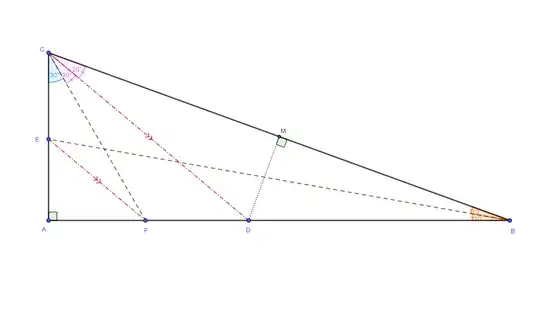

There is also a geometric proof without using $(1)$. Let $ABC$ be a triangle with $\angle BAC=90^\circ$ and $\angle ABC=20^\circ$. Let $E$ and $F$ be internal points of $AC$ and $AB$ such that $BE$ bisects $\angle ABC$ and $\angle ACF=30^\circ$. We want to show that $\angle CFE=20^\circ$.
Note that $\angle BCF=40^\circ$. If $D$ is an internal point of $BF$ such that $CD$ bisects $\angle BDC$, then $\triangle DBC$ is isosceles. Therefore, $DM\perp BC$ if $M$ is the midpoint of $BC$.
By the angular bisector theorem on $\triangle ABC$, $\frac{AE}{CE}=\frac{AB}{BC}$. Since $\triangle MBD\sim \triangle ABC$, we have $$\frac{DM}{BM}=\frac{BC}{AB}=\frac{CE}{AE}.$$ Since $BM=\frac12 BC$, we get $$DB=\frac{CE}{AE} \cdot BM=\frac{BC\cdot CE}{2\cdot AE}.$$
Using the angular bisector theorem with $\triangle FCB$, we get $\frac{DF}{DB}=\frac{CF}{BC}$ so that $$DF=\frac{CF}{BC}\cdot DB=\frac{CE}{AE}\left(\frac{CF}{2}\right).$$ Since $\triangle ACF$ is a right triangle with $\angle ACF=30^\circ$, we get $AF=\frac{CF}{2}$ so that $DF=\frac{CE}{AE}\cdot AF$ or $$\frac{DF}{AF}=\frac{CE}{AE}.$$ This means $EF\parallel CD$. Hence $$\angle CFE=\angle FCD=\frac{1}{2}\angle BCF=20^\circ.$$
From this result, we see using the law of sines on $\triangle CFE$ that $$\frac{CE}{\sin 20^\circ}=\frac{CF}{\sin 130^\circ}=\frac{CF}{\sin 50^\circ}=\frac{CF}{\cos 40^\circ}.$$ Also the law of sines on $\triangle BCF$ yields $$\frac{CF}{\sin 20^\circ}=\frac{BC}{\sin 120^\circ}=\frac{BC}{\sin 60^\circ}.$$ Therefore $$\frac{CE}{\sin 20^\circ}=\frac{BC\sin 20^\circ}{\sin 60^\circ \cos 40^\circ}.\tag{2}$$ But using the law of sines with $\triangle BCE$ gives us $$\frac{CE}{\sin 10^\circ}=\frac{BC}{\sin 100^\circ}=\frac{BC}{\sin 80^\circ}=\frac{BC}{2\sin 40^\circ \cos40^\circ}.\tag{3}$$ From $(2)$ and $(3)$ we obtain $$\frac{BC \sin 10^\circ}{2\sin 40^\circ \cos 40^\circ}= CE=\frac{BC\sin^2 20^\circ}{\sin 60^\circ \cos 40^\circ}.$$ This proves that $$\sin^2 20^\circ \sin 40^\circ =\frac{1}{2}\sin 10^\circ \sin 60^\circ =\sin 10^\circ \sin 30^\circ \sin 60^\circ.$$ And from this result, we can prove $(1)$ as well.
