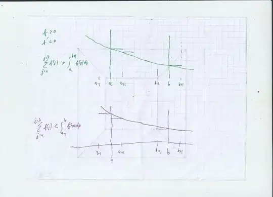

The limit of the ratio in your title is nonzero. Give me a few minutes to type up the following, based on your funtion $g(x) = x^{-1/3}$
if we have $g(x) > 0$ but $g'(x) < 0,$ then $$ \int_a^{b+1} \; g(x) \; dx \; < \; \sum_{j=a}^b \; g(j) \; < \; \int_{a-1}^b \; g(x) \; dx $$
Here is a drawing I made, using the letter $f$ rather than $g$
Well, $g$ is integrable at the origin. Let's try $a=1.$ If that is not satisfactory we can just switch to $a=2$ by putting in some extra terms.
$$ \int_1^{n+1} \; x^{-1/3} \; dx \; < \; \sum_{j=a}^b \; j^{-1/3} \; < \; \int_{0}^n \; x^{-1/3} \; dx $$
an antiderivative of $g$ is $G(x) = \frac{3}{2} x^{2/3}$
$$ \frac{3}{2} \left( (n+1)^{2/3} - 1 \right) \; < \; \sum_{j=1}^n \; j^{-1/3} \; < \; \frac{3}{2} n^{2/3} $$
Good enough. Your denominator is simply $ n^{2/3}.$ We see that $$ L = \frac{3}{2} $$

    Thank you very much for the explanation! Is this a form of the squeeze theorem? Since antiderivative is opposite to derivative, this is opposite to L'Hospital? – Matcha Latte Jan 21 '20 at 18:30
    @VerkhovtsevaKatya I do not know a name for this. When I took calculus, this and the pictures were in every calculus book. If you can borrow a book written 45 years ago, you will find this. – Will Jagy Jan 21 '20 at 19:08
