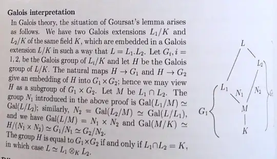

The second question is about the application of Goursat's Lemma in Galois theory. I read about it in Serre, but it would be very useful to have a concrete example of it being applied.

Here’s two trivial examples in Galois Theory.
  1. Consider the extension $L=\mathbb{Q}(\sqrt{2},\sqrt{3})$ over $\mathbb{Q}$. You have the intermediate extensions $L_1=\mathbb{Q}(\sqrt{2})$, with Galois group $C_2$ over $\mathbb{Q}$, and $L_2=\mathbb{Q}(\sqrt{3})$ with Galois group $C_3$. Thus, the Galois group of $L$ over$\mathbb{Q}$ embedds into $C_2\times C_2$; because $L_1\cap L_2=\mathbb{Q}$, so we get $\mathrm{Gal}(L/\mathbb{Q}) = C_2\times C_2$.
  2. Now consider $L$, the splitting field of $(x^4-2)(x^4-3)$ over $\mathbb{Q}$, with $L_1$ the splitting field of $x^4-2$ and $L_2$ the splitting field of $x^4-3$. Each of them is obtained by first adding $i$ and then adding $\sqrt[4]{r}$, with $r=2$ and $3$, giving you a dihedral group of order $8$. Thus, the Galois group of $L/\mathbb{Q}$ is a subdirect product of $D_4\times D_4$ (with $D_n$ the dihedral group of degree $n$ and order $2n$). In this case, $M=L_1\cap L_2=\mathbb{Q}(i)$, so you do not get the whole direct product. Instead, note that $\mathrm{Gal}(L_i/M)$ is cyclic of order $4$. So $\mathrm{Gal}(L/M) \cong C_4\times C_4$ with $\mathrm{Gal}(M/\mathbb{Q}) \cong C_2$. The group $\mathrm{Gal}(L/\mathbb{Q})$ is a subdirect product of $D_4\times D_4$, given by taking the cyclic group of order $4$ in each copy, and taking the graph of the identity isomorphism of $(D_4/C_4)\times(D_4/C_4)$.

  • Thank you very much for your answer, it it all clear for me now. I just added a screen of the part in Serre's book about the application to Galois theory. I hope you can look at it later :) – rae306 Jan 20 '20 at 18:44
  • @rae306: Added two examples that come to mind, where the extensions are disjoint and non-disjoint. Don’t know if they will help, though... – Arturo Magidin Jan 20 '20 at 19:30
  • Thank you for the additional comments! I accepted the answer, thanks for your time :) – rae306 Jan 20 '20 at 20:03
