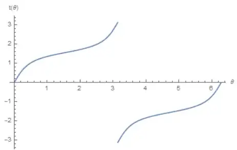

You are interested in an angle $t \in (-\pi,\,\pi]$:
$$ t = \text{arctan2}\left(x_p/a, \, y_p/b\right) $$
i.e.
$$ t = \begin{cases} \arctan\left(\frac{y_p/b}{x_p/a}\right) - \pi & \text{if} \; x_p < 0 \, \land \, y_p < 0 \\ \arctan\left(\frac{y_p/b}{x_p/a}\right) + \pi & \text{if} \; x_p < 0 \, \land \, y_p \ge 0 \\ -\frac{\pi}{2} & \text{if} \; x_p = 0 \, \land \, y_p < 0 \\ \frac{\pi}{2} & \text{if} \; x_p = 0 \, \land \, y_p > 0 \\ \arctan\left(\frac{y_p/b}{x_p/a}\right) & \text{if} \; x_p > 0 \end{cases} $$
{a, b} = {6, 2};
x[θ_] := a b Cos[θ] / Sqrt[(a Sin[θ])^2 + (b Cos[θ])^2]
y[θ_] := a b Sin[θ] / Sqrt[(a Sin[θ])^2 + (b Cos[θ])^2]
Plot[ArcTan[x[θ] / a, y[θ] / b], {θ, 0, 2π}, AxesLabel -> {"θ", "t(θ)"}]
therefore, known the integration extremes $t_1 \le t_2$, the length of the ellipse arc is equal to:

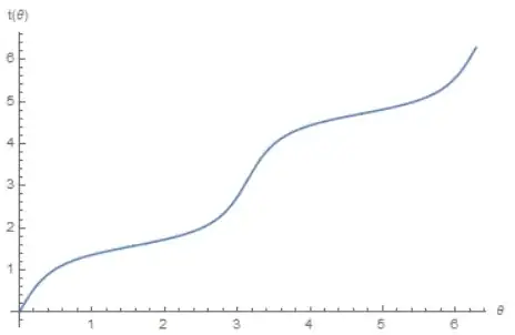

You are interested in an angle $t \in [0,\,2\pi)$:
$$ t = \begin{cases} \text{arctan2}\left(x_p/a, \, y_p/b\right) + 2\pi & \text{if} \; \text{arctan2}\left(x_p/a, \, y_p/b\right) < 0 \\ \text{arctan2}\left(x_p/a, \, y_p/b\right) & \text{if} \; \text{arctan2}\left(x_p/a, \, y_p/b\right) \ge 0 \\ \end{cases} $$
i.e.
$$ t = \begin{cases} \arctan\left(\frac{y_p/b}{x_p/a}\right) + \pi & \text{if} \; x_p < 0 \\ \frac{3\pi}{2} & \text{if} \; x_p = 0 \, \land \, y_p < 0 \\ \frac{\pi}{2} & \text{if} \; x_p = 0 \, \land \, y_p > 0 \\ \arctan\left(\frac{y_p/b}{x_p/a}\right) + 2\pi & \text{if} \; x_p > 0 \, \land \, y_p < 0 \\ \arctan\left(\frac{y_p/b}{x_p/a}\right) & \text{if} \; x_p > 0 \, \land \, y_p \ge 0 \end{cases} $$
{a, b} = {6, 2};
t[x_, y_] := Piecewise[{{ArcTan[x, y] + 2π, ArcTan[x, y] < 0},
                        {ArcTan[x, y], True}}]
Plot[t[x[θ] / a, y[θ] / b], {θ, 0, 2π}, AxesLabel -> {"θ", "t(θ)"}]
