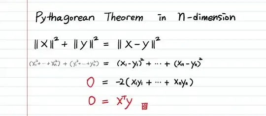

Also "by definition", two non-zero vectors are said to be orthogonal when (if and only if) their dot product is zero.
This can also be demonstrated by Pythagorean theorem.
- 149
While this link may answer the question, it is better to include the essential parts of the answer here and provide the link for reference. Link-only answers can become invalid if the linked page changes. - From Review – FD_bfa Mar 02 '23 at 22:59
Hi @FD_bfa, I added essential parts of the answer to the body. Thank you for the suggestion. – aerin Mar 03 '23 at 00:25
