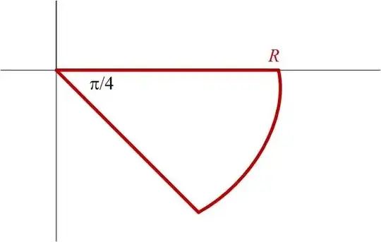

where $C$ is the following contour:
That is, a $45^{\circ}$ wedge of radius $R$, where we will set $R \rightarrow \infty$. Because there are no poles inside the contour, the above integral is zero. We then write the integral around this contour as
$$\oint_C dz \: e^{-z^2}=\int_0^R dx \: e^{-x^2} + R \int_0^{-\pi/4} d\theta \: e^{-R^2 \cos{2 \theta}} e^{-i R^2 \sin{2 \theta}} + e^{-i \pi/4} \int_R^0 dv \: e^{i v^2}=0$$
I hope you see that the second integral, that about the arc, vanishes as $R \rightarrow \infty$. It vanishes because of the exponential term in the integrand which vanishes very quickly in this limit. Because this integral vanishes, we are then left with the following relation:
$$\int_0^{\infty} dx \: e^{-x^2} - e^{-i \pi/4} \int_0^{\infty} dv \: e^{i v^2} = 0$$
