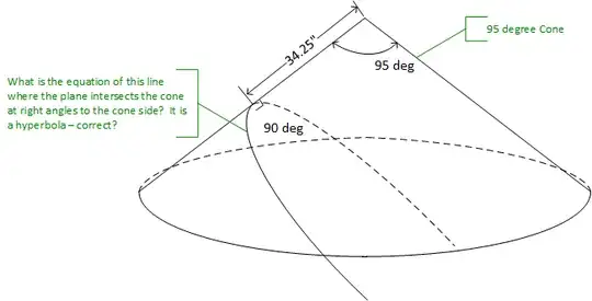

Plane intersecting a $95^\circ$ cone at right angles:
I'm trying to build a homemade tracking platform for my telescope. I'm hoping that I can come up with an equation that I can use to cut a bearing for it on a milling machine. I think it is a hyperbola generated by the intersection of a plane to a cone. The plane intersects the cone $34.25$ inches from the tip and at a right angle. The cone has an angle of $95^\circ$ (twice my latitude).
Blue
  • 83,939
  • There isn’t “an equation” to describe this curve. In general, a curve in 3-d requires a system of two implicit equations. One can obtain a parameterization of the curve (which is really a set of three equations) so that varying the single parameter traces out the curve. Is that what you’re looking for? – amd Jan 01 '20 at 20:53
  • I was looking for a 2-d version projected on that intersecting plane. Something like $$1 = \frac{(y-k)^2}{a^2}-\frac{(x-h)^2}{b^2} $$ – Curtis Thompson Jan 01 '20 at 21:38
  • @Blue: fully right, sorry for the mistake – G Cab Jan 01 '20 at 21:55
  • @Curtis Thompson Wooden cone? Btw If there is a means to fix the cone ( a hole along axis ?) and tilt axis (universal milling machine table ) at the right inclination you could perhaps straight away part them on the machine using a slicing milling cutter, or at least mark the line with a sharp tool. – Narasimham Jan 02 '20 at 03:28
  • @Narasimham, That is exactly what I did. Wood sort of worked but rough. I'd like to make the bearing out of 3/8" aluminum but my jig to make it is not rigid enough and the cutter chatters a lot. – Curtis Thompson Jan 03 '20 at 16:02

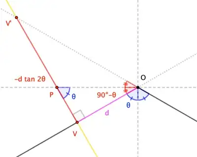

Here's a side view of the scenario. Point $O$ is the tip of your cone. The cone's axis is the vertical through $O$; the horizontal represents the plane perpendicular to the axis at $O$. Angle $\theta$ is half the cone angle; so, it's your latitude. The cutting plane is represented by $\overleftrightarrow{VV'}$, which cuts the cone at a point at distance $d$ from $O$.
This answer explains that the eccentricity of a conic —call it $e$— is given by the angles made by the cone and by cutting plane with that horizontal plane. Here, we have $$e = \frac{\sin\angle VPO}{\sin\angle POV} = \frac{\sin\theta}{\sin(90^\circ-\theta)}=\frac{\sin\theta}{\cos\theta}=\tan\theta \tag{1}$$
The hyperbola's transverse axis is given by $$|VV'| = d\tan\angle VOV' = d\tan(180^\circ-2\theta)=-d\tan 2\theta \tag{2}$$
(Note that $2\theta$ here is $95^\circ$, an obtuse angle with a negative tangent; thus, the negative sign in $(2)$ makes the value positive, as expected.)
Choosing convenient coordinates in the cutting plane ($x$-axis aligned with $\overline{VV'}$, origin at the segment's midpoint), the equation of the hyperbola in that plane is
$$\frac{x^2}{a^2}-\frac{y^2}{b^2} = 1 \tag{3}$$ where $$\begin{align} a &= \frac12|VV'| &&= -\frac12d\tan 2\theta \\[4pt] b &= a\sqrt{e^2-1} &&= -\frac12d\tan2\theta\sqrt{\tan^2\theta-1}=\frac{d}{\sqrt{1-\cot^2\theta}} \end{align} \tag{4}$$
In the particular case where $\theta = 95^\circ/2 = 47.5^\circ$ and $d = 34.25$, this gives $$a = 195.74 \qquad b = 85.5349$$ Since $e = 1.09131$, this is "close" to a parabola near the vertex, although the resemblance fails quickly, as the hyperbola approaches asymptotes and a parabola, of course, doesn't.
Blue
  • 83,939
    Very nice! Exactly what I was looking for. I will carefully verify before committing to the milling machine. – Curtis Thompson Jan 02 '20 at 00:02
    Blue, The data I get from your equation seems to match what I see from my feeble attempt at making the bearing free-hand. Thanks again. – Curtis Thompson Jan 02 '20 at 01:11
    Your results agree with mine obtained via a different method. – amd Jan 02 '20 at 07:50
  • @CurtisThompson and @ amd: Good to know. I'm annoyed (and embarrassed) by how often a silly error has made me redo a project on my laser cutter, so I want to be extra-cautious when someone else's materials are on the line. :) – Blue Jan 02 '20 at 08:07

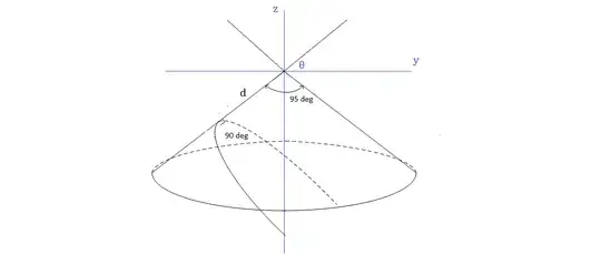

In Cartesian coordinate, the surface equation of the cone is
$$z^2 = \tan^2\theta(x^2+y^2)\tag 1$$
where $\theta = \frac {85}2=42.5$ deg. The normal vector to the surface of the cut is $n =(0, \cos\theta, \sin\theta)$ and the vertex point of the cut is $V(0, -d\cos\theta, -d\sin\theta)$. Then, for any point $P(x,y,z)$ in the plane of the cut, $n\cdot(P-V)=0$ holds. Explicitly, the equation of the plane is
$$y\cos\theta+z\sin\theta+d=0\tag 2$$
Thus, the equation for the edge of the cut is given by the intersection of the cone (1) and the plane (2), which is a hyperbola. For instance, it is seen from its projection onto the $xy$-plane obtained by eliminating $z$,
$$x^2 - (\cot^4\theta - 1)y^2 +2d\csc\theta\cot^3\theta\> y - d^2\csc^2\theta \cot^2\theta= 0$$
which is a hyperbola because $\cot^4\theta - 1>0$.
