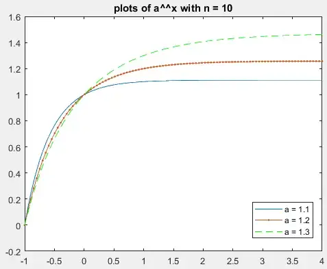

where $\log^{\circ n}$ is the logarithm applied $n$ times. As an example, with $n=10$, I obtained the following plot:
large a, small n

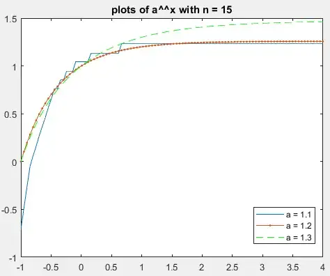

which looks really nice. Then looking at $n=15$, I get this:
large a, large n

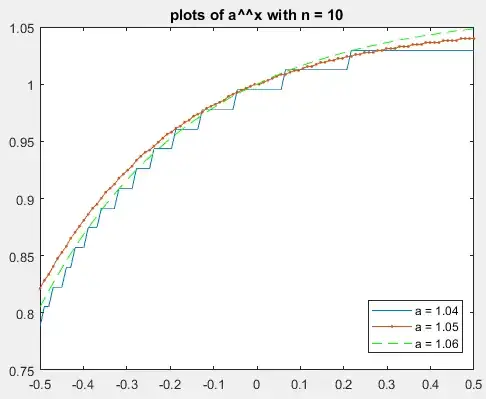

which raises concern. For $a$ close to $1$ and $n=10$, I get
a near 1, small n
It would seem to work well for small $n$ and large $a$, but then for larger $n$ or smaller $a$, it becomes unstable. As far as I can tell, this issue is due to the amount of numerical precision required while evaluating $(1)$, especially when the base is closer to $1$.
So the first question is whether this is due to numerical precision, or if it's simply because $(1)$ does not converge.
If it's the former, then is there any way to circumvent this without brute forcing with more precision? And how should I pick the values of $n$ for a given base $a$ (and $x$)?
If it's the latter, then does it converge anywhere?

Conclusion of what follows below is that the formula/implementation is subject to catastrophic cancellation in the part ${}^\infty a-{}^na$.
I have implemented your code verbatim in MATLAB. The result with double precision is identical (subject to $\pm 1$ shift somehow in the counter $k$) for $k=25,50,100$.
>> test_double(25)
inf_a - n_a = 4.5947e-05
res =
   1.538798995072006
>> test_double(50)
inf_a - n_a = 4.8182e-09
res =
   1.538805596316793
>> test_double(100)
inf_a - n_a = 1.3323e-15  % Close to machine epsilon for 64 bits (!!!)
res =
   2.000000000000001
Now increasing the precision to quadruple (digits = 32)
