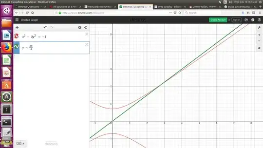

The inqualities: in the first quadrant, on the hyperbola arc we always have $y > \frac{x}{\sqrt 2} > \frac{2x}{3}.$ However, the only integer point of the arc in the first quadrant with $y > \frac{3x}{4}$ is $(1,1).$ Note that the solution point $(7,5)$ is below the green line.
