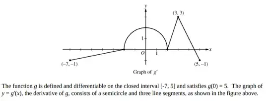

We learned last class, if I remember correctly, that a function cannot be differentiable at endpoints of an interval because the two-sided limit of the difference quotient can't exist. Now we are told the function $g$ is differentiable on the same closed interval on which it is defined. What gives?
Is what we learned last class incorrect, is the above problem incorrect, or is my interpretation of either incorrect? Any ideas?
Differentiability and continuity at endpoints has always been a topic that confuses me, even though I think I understand the concepts at interior points. I seem to remember us learning last class that differentiability requires being able to approach a point from both sides, which you can't do at endpoints, right?

When you want to check if a function is differentiable at its endpoints you only need to check if the $one-sided$ limit exists and is a real number. That's because the two sided limit isn't even defined for the endpoints.
When you want to check if a function is differentiable at an interior point, you need to check the $two-sided$ limit (which needs to exist and be a real number in order for your function to be differentiable at this point).
This answer will help you too.
I found the link after writing the first two mini-paragraphs of my answer and I think that this is the most common definition given (and the one given to me at school by my teachers), so I will leave them(the two paragraphs) here.
