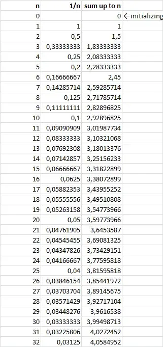

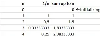

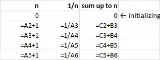

There are good approximations as shown by the previous answers. Doing it intelligently you get very good estimates. However, it seems to me that the exact value of $n$ can only be determined by explicit calculations. I used Excel:
enter image description here $\quad$ enter image description here
Here is the complete table up to $n = 32$. Note that Excel uses $8$ decimals, thus the rounding error in these calculations does not affect our result $n = 31$.
