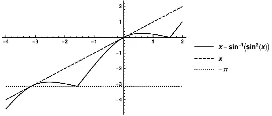

Let $f(x)=x-\arcsin(\sin^2(x))$ then $f'(x)=1-\frac{2\sin(x)\cos(x)}{\sqrt{1-\sin^4(x)}}$ so $f'(x)<1$ for $x\in(0,1]$. Therefore $f(x)<x$ for $x\in(0,1]$ since $f(0)=0$ so your sequence decreases. Also $f(x)>0$ since $f(1)>0$ and $f$ has a local maximum on $(0,1)$. So your sequence is decreasing and bounded and therefore convergent. The limit $L$ must satisfy $L=L-\arcsin(\sin^2(L))\Longleftrightarrow L=\pi z$ with $z\in\mathbb{Z}$ and since $0<a_n<1$ we get $L=0$.
For $x\in[-1,0)$ we have $f'(x)>1$ so again $f(x)<x$ for $x\in[-1,0)$. This also holds for $x\in(-\pi,0)$: Since $f$ is increasing on $(-\frac{\pi}{2},0)$ and has a local maximum on $(-\pi,-\frac{\pi}{2})$ $f$ must have a local minimum at $(-\frac{\pi}{2}\mid-\pi)$ since the function is decreasing before, increasing after and $f'(-\frac{\pi}{2})$ is undefined. Since $f(x)=x\Longleftrightarrow x=\pi z$ with $z\in\mathbb{Z}$ we have $f(x)<x$ for $x\in(-\pi,0)$ and since $f(x)=-\pi\Longleftrightarrow x=-\pi\vee x=-\frac{\pi}{2}$ we have $f(x)\geq-\pi$ for $x\in[-\pi,0]$. So your sequence is decreasing and bounded and therefore convergent again. The limit $L$ must satisfy $L=\pi z$ again and since $-\pi\leq a_n<0$ we get $L=-\pi$.
Plot
