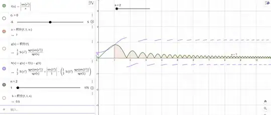

I constructed the graph of $\displaystyle\int_1^{\infty}\left|\dfrac{\sin (x^2)}{x}\right|dx$:
How is that possible for the integral to be less than $0$ on some intervals? What is wrong with my method? Can anybody give me some hints to prove or disprove its convergence?

  • The engine computes indefinite integral and definite integral in different ways. – xbh Dec 08 '19 at 03:06
  • @xbh Ok, then how to calculate the integral? it is hard to evaluate... – Kevin.S Dec 08 '19 at 03:08

Proof for divergence of $$ \newcommand{\abs}[1]{\left\vert #1 \right\vert} \newcommand\rme{\mathrm e} \newcommand\imu{\mathrm i} \newcommand\diff{\,\mathrm d} \DeclareMathOperator\sgn{sgn} \renewcommand \epsilon \varepsilon \newcommand\trans{^{\mathsf T}} \newcommand\F {\mathbb F} \newcommand\Z{\mathbb Z} \newcommand\R{\Bbb R} \newcommand \N {\Bbb N} \renewcommand\geq\geqslant \renewcommand\leq\leqslant \int_1^{+\infty} \abs {\frac {\sin (x^2)}{x}} \mathrm dx. $$ Easy to see $\abs {\sin (x^2)} \geq\sin^2 (x^2) = (1 - \cos (x^2))/2$ since $0 \leq \abs {\sin (u)} \leq 1$. Then $$ \int_1^{ +\infty } \frac {\abs {\sin (x^2)}}x \geq \frac 12 \int_1^{+\infty} \frac 1x \diff x - \frac 12 \int_1^{+\infty} \frac {\cos (2x^2)}x \diff x =: \frac 12( I_1 + I_2). $$ Clearly $I_1$ diverges. For $I_2$, via the substitution $u = 2x^2$, or $x = \sqrt {u/2}$, $$ I_2 = \int_2^{+\infty} \frac {\cos u} {\sqrt {u/2}} \diff \sqrt {u/2} = \int_2^{+\infty} \frac {\cos u} {2u} \diff u, $$ and this is convergent by Dirichlet Test. Therefore the original integral is a sum of a divergent integral and a convergent integral, which shall be divergent as well.
