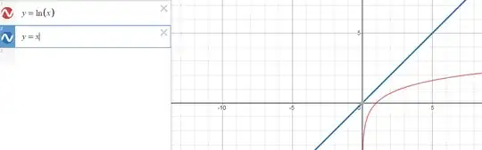

Personally, when two functions $g(x)$ and $f(x)$ both tend to infinity for $x→+∞$ but with different "speeds", I consider the hierarchy of infinites. The function $g(x)=x$ to the denominator dominates the function $f(x)=\ln x$ to the numerator because it goes faster than the $\ln x$ as you can see with this graph created with Desmos:
It's practically as if I had a constant at the numerator and an infinitely great function at the denominator. Therefore:
$$\lim_{x\to 0}\frac{\ln(x)}x=0$$
