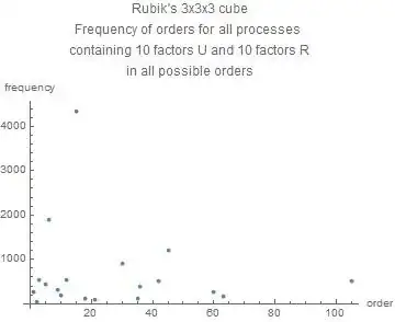

Find as many possible orders with the most simple ingredients. To this end we calculate the orders of all processes which can be constructed from $n$ factors $U$ and $n$ factors $R$ in all possible orders, with $1\le n \le 8$. Here's the list of all orders that appear
$\{1,2,3,(4,)5,6,9,10,12,15,18,20,21,30,35,36,42,45,60,63,105\}$
Notice that the order $4$ appears only for $R$ and $U$ itself.
The frequency of orders for $:U^{10} R^{10}:$ is shown in the follwing picture
