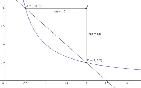

Geometrically, we can envision this with the graph of a curve on an $xy$-plane, as in the picture below. When we pick two points on the curve, this will correspond to a pair of values: the horizontal change (run, $\mathrm{d}x$) and vertical change (rise, $\mathrm{d}y$), whose ratio, $\frac{\mathrm{d}y}{\mathrm{d}x}$, is the slope or derivative. Intuitively, you can think that dividing both sides of this ratio by the small change, $\mathrm{d}u$, does not change its value. Hence, $\frac{\mathrm{d}y}{\mathrm{d}x}=\frac{\mathrm{d}y/\mathrm{d}u}{\mathrm{d}x/\mathrm{d}u}$, which rearranges to $\displaystyle \frac{\mathrm{d}y}{\mathrm{d}u}=\frac{\left(\frac{\mathrm{d}y}{\mathrm{d}x}\right)}{\left(\frac{\mathrm{d}u}{\mathrm{d}x}\right)}$. This is known as the Chain Rule. In your case, we set $u=(x^2)$ and have $\displaystyle\frac{\mathrm{d}y}{\mathrm{d}(x^2)}=\frac{\frac{\mathrm{d}y}{\mathrm{d}x}}{\frac{\mathrm{d}(x^2)}{\mathrm{d}x}}=\frac{1}{2x}\frac{\mathrm{d}y}{\mathrm{d}x}$ by the Power Rule.
You should be able to use this to explain what happens with higher powers. But whether the result is 'trivial' or not is simply a matter of perspective. Hopefully this explains your question in the comments about where the factor of $\frac{1}{2x}$ arises from. A small change in $x$ corresponds to a large change in $x^2$ **, which means the slope of $y$ with respect to $x^2$ must have a larger run than the slope with respect to $x$. Therefore, $\frac{\mathrm{d}y}{\mathrm{d}(x^2)}<\frac{\mathrm{d}y}{\mathrm{d}x}$.

Credit to Jake Binnema - Secant Slope Calculator for the image.
