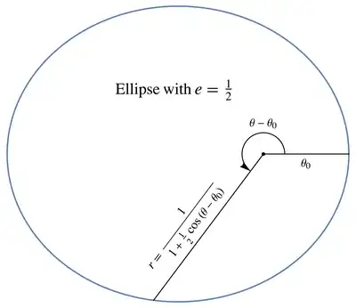

It turns out that the solution to these equations does have $r$ as a function of $\theta$, but this depends greatly on this particular potential function.
Starting with $$ \ddot{r}-r\dot\theta^2=-\frac{GM}{r^2}\tag1 $$ and $$ r\ddot\theta+2\dot{r}\dot\theta=0\tag2 $$ equation $(2)$ says that $$ \dot\theta=\frac{k_1}{r^2}\tag3 $$ Plugging $(3)$ into $(1)$ gives $$ \ddot{r}=\frac{k_1^2}{r^3}-\frac{GM}{r^2}\tag4 $$ Apply $\frac{\mathrm{d}}{\mathrm{d}t}=\frac{k_1}{r^2}\frac{\mathrm{d}}{\mathrm{d}\theta}$: $$ \begin{align} \dot{r} &=\frac{k_1}{r^2}\frac{\mathrm{d}r}{\mathrm{d}\theta}\\ &=-k_1\frac{\mathrm{d}\frac1r}{\mathrm{d}\theta}\tag5 \end{align} $$ and again: $$ \begin{align} \ddot{r} &=-\frac{k_1^2}{r^2}\frac{\mathrm{d}^2\frac1r}{\mathrm{d}\theta^2}\\ &=\frac{k_1^2}{r^3}-\frac{GM}{r^2}\tag6 \end{align} $$ Therefore, $$ \begin{align} \frac{\mathrm{d}^2\frac1r}{\mathrm{d}\theta^2} &=\frac{GM}{k_1^2}-\frac1r\tag7 \end{align} $$ Thus, $$ \frac{GM}{k_1^2}-\frac1r=k_2\cos(\theta-\theta_0)\tag8 $$ Solving for $r$ yields $$ r=\frac1{\frac{GM}{k_1^2}-k_2\cos(\theta-\theta_0)}\tag9 $$ which is the polar equation for an ellipse, but the important part is that $r$ is a function of $\theta$.
