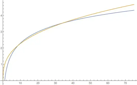

In answer to your comment, here's a plot of $\log t$ (in blue) and $t^{1/(2p)}$ for $p=1.4$, for example. As you can see, $t_0\approx 35$ in this case, after which the inequality holds true for $t\geq t_0$. This always happens for some $t_0$ value.

  • And why we are assuming "for large enough $t_0 \ge 1$" ? –  Nov 26 '19 at 10:51
  • Why "$\ln t \le \sqrt[2p]{t}$"? –  Nov 26 '19 at 11:00
  • Is there any mathematical proof for my last question other than the drawing? –  Nov 26 '19 at 11:11
    @Mathstupid yes, check out https://math.stackexchange.com/questions/1663818/does-the-logarithm-function-grow-slower-than-any-polynomial – pshmath0 Nov 26 '19 at 11:47
