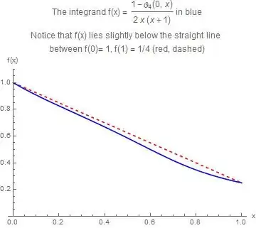

$$s_i = \int_0^1 f(x) \, dx\tag{2a}$$
where the integrand is defined as
$$f(x) = \frac{1-\vartheta _4(0,x)}{2 x (x+1)}\tag{2b} $$
Here
$$\vartheta _4(u,q) = 1 + 2 \sum_{n=1}^{\infty} (-1)^n q^{n^{2}} \cos(2 n u)\tag{3}$$
is a Jacobi theta function $[1]$.
The integrand of $s_i$ looks pretty harmless

$$f(x) = \left\{1,-x,x^2,-2 x^3,2 x^4,-2 x^5,2 x^6,-2 x^7,3 x^8,-3 x^9,3 x^{10},-3 x^{11},3 x^{12},-3 x^{13},3 x^{14},-4 x^{15}\right\}$$
When integrated
$$s=\int_0^1 f(x) \,dx \simeq \left\{1,-\frac{1}{2},\frac{1}{3},-\frac{1}{2},\frac{2}{5},-\frac{1}{3},\frac{2}{7},-\frac{1}{4},\frac{1}{3},-\frac{3}{10},\frac{3}{11},-\frac{1}{4},\frac{3}{13},-\frac{3}{14},\frac{1}{5},-\frac{1}{4}\right\}$$
we get back where we started from.

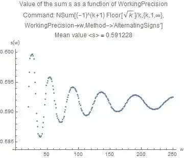

The accuracy issue is briefly that - roughly speaking - Mathematica gives a different numerical result for the integral with NIntegrate than for the sum with NSum. I believe that the value obtained with NIntegrate is better because the integrand is alsmost trivial (see the graph). We had a similar topic recently here.
In the meantime, Yuriy S in a comment has given this numerical value for the integral $(2)$ with Mathematica's NIntegrate, and WorkingPrecision -> 30
$$i_{Yuriy} = 0.591560779349817340213846903345$$
I can confirm this result.
I have calculated the sum with NSum and different values of WorkingPrecision. The results are wobbling appreciably about the limiting value as can be seen in the picture
And I can ony give this very modest result (the average)
$$s_{WH,NSum} = 0.59123$$
Alternatively, the plain Sum of the first million terms is
$$s_{WH,Sum} = 0.5910$$
The accuracy is but $\frac{1}{\sqrt{k_{max}}} \simeq 10^{-3}$

Mathematica finds 5 valid digits for $s_{RL}$ with 1000 n-summands in a few seconds, but refuses to sum 2000 terms is acceptable time.
However, River Li found twenty digits using Maple, a result he later confirmed using the "Convergence Acceleration methods for Alternating Sums" as described here $[3]$ with only 28 terms. This method claims that you can get high precision results from just a few tens of terms. Usage of the method is nicely described in the update of River Li's solution.
Hence I conclude that using summation to find the value of the sum with high accuracy as requested in problem b) needs sophisticated summation methods which provide convergence acceleration, accompanied by a good SC-tool.
Here we are lucky to have the integral representation of the sum for which Mathematica delivers as many digits as requested.

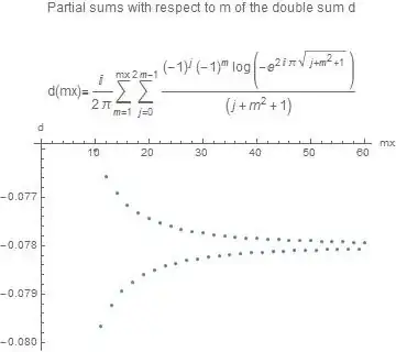

$$d=-\frac{1}{\pi}{\sum_{n\geq 1}\sum_{k\geq 1}\frac{\left(-1\right)^{n}\sin\left(2\pi k\sqrt{n}\right)}{nk}}\tag{5.2}$$
We can do the $k$-sum
$$\sum_{k\geq 1} \frac{\sin\left(2\pi k\sqrt{n}\right)}{k}= \frac{i}{2}\left(\log \left(1-e^{2 i \pi \sqrt{n}}\right)-\log \left(1-e^{-2 i \pi \sqrt{n}}\right)\right) \\ = \frac{1}{2} i \log \left(\frac{1-e^{2 i \pi \sqrt{n}}}{1-e^{-2 i \pi \sqrt{n}}}\right)\\ =\frac{1}{2} i \log \left(-e^{2 i \pi \sqrt{n}}\right)\tag{5.3}$$
Here is another expression for d
$$d_{nsq}=\frac{i}{2\pi }\sum _{m=1}^{\infty }(-1)^m \sum _{j=1}^{2 m} (-1)^j\frac{ \log \left(-e^{2 i \pi \sqrt{j+m^2}}\right)}{ \left(j+m^2\right)}\tag{5.10}$$
The convergence is satisfactory as can be seen from the following graph
