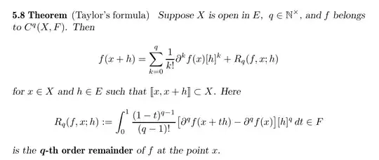

I'm reading the Taylor's theorem for Banach spaces:
enter image description here Here $E,F$ are Banach spaces.
We have $$R_{q}(f, x ; h):=\int_{0}^{1} \frac{(1-t)^{q-1}}{(q-1) !}\left[\color{blue}{\partial^{q} f(x+t h)}-\partial^{q} f(x)\right][h]^{q} \,\mathrm d t \in F$$
Because $\partial^{q} f(x+t h)$ appears in the remainder, $\partial^{q} f$ must exist in a neighborhood of $x$ that containing $h$.

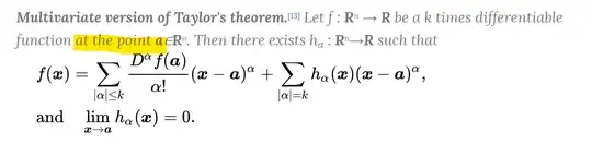

My question:
Is it possible to generalize this version of Taylor's theorem to the case $\partial^q f$ exists only at one point? Just as in the case $E = \mathbb R^n$.
