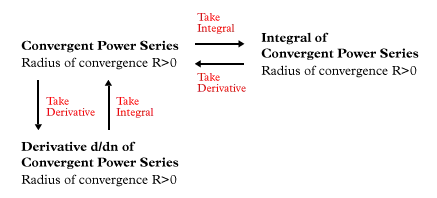

Here is how I understand how taking the derivative and integral of a convergent power series $\sum_{n=0}^{\infty} a_nx^{n}$ works:
So, for (a), I think I would need a power series that: (1) has a radius of convergence of 0, and (2) has a derivative with a radius of convergence $R>0$.
