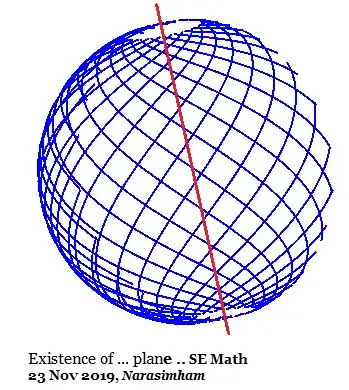

The set of points on a 2D smooth surface on two curvilinear parameters $(u,v)$:
$$ (x,y,z) = (f(u,v), g(u,v), h(u,v)) $$ which belongs to a specific pattern defined by these three functions with continuous partial derivatives.
Given points $ (x(u,v),y(u,v),z(u,v)) $ cannot be mapped/fitted in by a set of arbitrarily embedded scattered grid or net points (vertices) onto any patch in 3-space.
That said, specific examples can be given of non-arbitrary defined curvilinear orthogonal "square" projected planar grids in which you are interested.
In 3D conformal mapping using inversions, $90^{\circ}$ vertices get mapped onto a plane tangent to south pole in the following instances.
In Stereographic Projn latitudes and longitudes of the globe are projected in a plane forming.... polar grid or bipolar grid depending on whether chosen point of projection is from 1) the north pole or from 2) the equator.
Loxodromes/rhumb lines intersecting lat/long lines orthogonally at $45^{\circ}$ are given (before projection) by
$$ x= sech \theta \cos \theta, \,y= sech \theta \sin \theta, \, z= \tanh \theta $$
It would be interesting to find again such planar projections repeated with loxodromes/rhumb lines intersecting lat/long lines at $\pm 45^{\circ}$ as square curvilinear grids from the earlier two points (pole and equator).
Ortho Loxodromes
