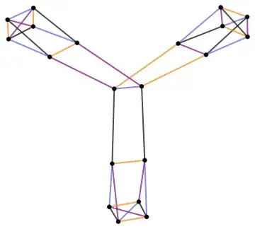

The graph from here, found via a House of Graphs search and also pictured below, is $4$-regular, connected, and class $1$ (as the edge coloring shows), but not Hamiltonian:
Also, $3$-regular graph formed by the orange, black, and purple edges in the coloring above is connected, so this means that the answer is "no" to both of your questions.
