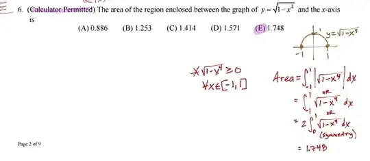

i don't even understand how to do this, surely this function is continuous at $|x|<1$ and have real value on that given integral. and $$\int_{-1}^{1}\sqrt{1-x^4}dx$$ should doable .
but since there isn't any variable outside root, i can't make any substitution of it. i'm trying sought on integral calculator but it said there isn't any antiderivative of this function .
so assuming this question is valid is there any way to solve this? ( i'm currently on mid-end of calculus 1). by the way the provided answer just attach half circular image that says "symmetry" and state $1.748$ is the answer and it doesn't make much sense for meenter image description here

  • thank you i really appreciate that even i'm still far from there , and i'm attached the image of the worksheet . how your thought about it ? – pikarin-g Nov 18 '19 at 13:00
It's an elliptic integral, which you are probably not expected to know anything about.
But note that $\sqrt{1-x^4}>\sqrt{1-x^2}$ for $-1<x<1$, and therefore $$ \int_{-1}^1 \sqrt{1-x^4} \, dx > \int_{-1}^1 \sqrt{1-x^2} \, dx = [\text{area of half the unit circle}] = \frac{\pi}{2} \approx 1.5708 . $$ So your integral is greater than $\pi/2$, and alternative (D) looks like a rounded value of $\pi/2$, and (E) is the only number which is larger, so the only alternative which can be correct is (E).
(Strictly speaking, it could be (D), since $1.571$ also also greater than $\pi/2$, but that possibility can be ruled out since the difference $1.571-\pi/2$ is so small that the total area between the graphs $y=\sqrt{1-x^4}$ and $y=\sqrt{1-x^2}$ must be greater.)
Hans Lundmark
  • 55,038
  • thanks a lot , since answer in worksheet is only make me confuse , it's keep highlighting on integral but not explain the nature of the function itself. – pikarin-g Nov 18 '19 at 13:48
  • @pikarin-g: Yes, if that handwritten stuff in the image you posted is supposed to be some kind of official answer key, it really doesn't provide much explanation...! – Hans Lundmark Nov 18 '19 at 13:58
