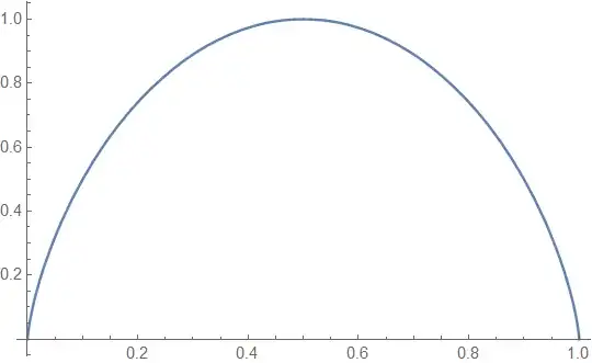

are increasing on $[0,1/2]$ and decreasing on $[1/2,0]$. For example, $\frac{f_{10}(x)}{f_{10}(1/2)}$ is given by the graph
$f_{10}(x)/f_{10}(1/2)

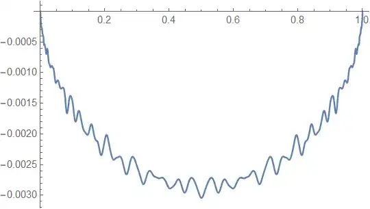

However, it seems that whatever function $f_n(x)$ is approaching is universal up to a constant regardless of $f_0(x)$ (provided $f_0(x)$ is continuous on $[0,1]$). For example, if $f_0(x)=\sin(2\pi x)$, then $f_{15}(x)$ looks like

EDIT: As was pointed out in the comments, the only reason the parabola-like curve appears is that $f_n(x)$ was normalized by $f_n(1/2)$ with that in mind, what can we say about the limit of
$$\frac{f_n(x)}{f_n(1/2)}$$
as $n$ goes to infinity. Does this curve have a shape? If so, does this shape have a closed form solution?

  • Yep, that seems to be the case. Still makes me wonder what that vaguely parabola-like curve is though – QC_QAOA Nov 12 '19 at 21:18
