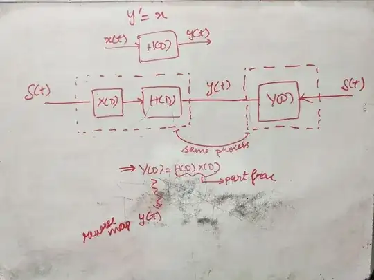

I mapped out the steps involved in solving a differential equation, $y'(t)=x(t)$ with the operator-method and using the Laplace transform.
Operator Method Operator Method
The Operator method: Assuming the inputs $x(t)$ and $y(t)$ are the impulse responses of a system with system operators $X(D)$ and $Y(D)$, will imply, $Y(D)=H(D)X(D)$, and then we can find $y(t)$ by reverse mapping. So a convolution in time domain $y(t)=h(t) * x(t)$ ($h(t)$ is the impulse response of the system) becomes multiplication in "operator" domain $Y(D)=H(D)X(D)$

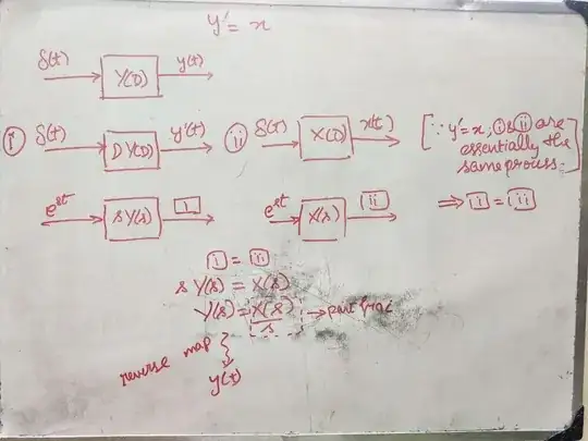

Using Laplace Transform enter image description here
Laplace Transform method: While taking laplace transform on both sides of a differential equation,$y'(t)=x(t)$ in this example, we are assuming y(t), is the impulse response of a system say sys1 and x(t) is the impulse response of another system say sys2. $Y(D)$ be the system operator of sys1. Now we need $y'(t)$, so the system operator becomes $DY(D)$ to produce $y'(t)$. And $X(D)$ be the system operator of sys2. Since $y'=x$ the two machines $DY(D)$ and $X(D)$ must be the same. Now if we give an input $e^{st}$ to sys1 and sys2, we know the system operator for sys1 becomes $sY(s)$ and for sys2 it's $X(s)$. Now as these two systems are equal, $sY(s)=X(s)$ which implies that $Y(s)=\dfrac{X(s)}{s}$. Now reverse map $Y(s)$ to obtain $y(t)$.
