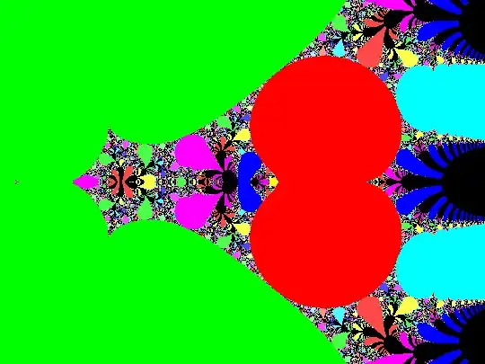

Sorry, I'm leaving an answer so I can show an image. Note the red colored large kidney in the center of the image. Escape of the exponential Mandelbrot map It is the location of period one convergence and is referred to as the Shell-Thron Region (STR). Immediately to left of the center of the STR is a small yellow disk of period two convergence. Note that $^{\infty}1 = 1$ is at the center of the STR where $^{\infty}a = a$, while center of the yellow disk is $0$.
A pragmatic answer is that $1$ drives the dynamics of the surrounding exponential Mandelbrot map and that $0$ does the same, therefore $0^0=1$. In combinatorics it is common to take $0^0$ as $1$.
