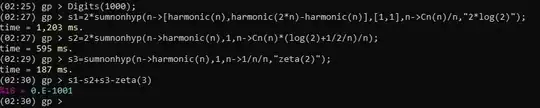

Naming $C_n(n)$ the normalized central binomial $\binom{2n}{n}\frac{1}{4^n}$, the following Pari/GP output provides the error between the sum and $\zeta(3)$.
$s_1=2\sum_{n=1}^\infty C_n(n) H_n [H_{2n}-H_n]/n$
$s_2=2\sum_{n=1}^\infty C_n(n) H_n [\log(2)+\frac{1}{2n}]/n$
$s_3=\sum_{n=1}^\infty H_n/n^2$
such that $s=s_1-s_2+s_3$. Using 1000 decimal digits the difference with $\zeta(3)$ is 0.
Jorge Zuniga
  • 543
  • 11
    As it’s currently written, your answer is unclear. Please [edit] to add additional details that will help others understand how this addresses the question asked. You can find more information on how to write good answers in the help center. – Community Mar 07 '22 at 05:42
  • This is not proof, and this question was fully answered some years ago already. They know the difference with $\zeta(3)$ is $0$... – FShrike Mar 07 '22 at 06:44
  • I know It is not a proof, even it is not an answer. I coded a function to evaluate slowly convergent monotone series that cannot be worked with Math commercial software. It uses a novel approach with combinatorics (partitions) and deep Abel summation. This is an excellent example to test it. I hope it is not misinterpreted. – Jorge Zuniga Mar 07 '22 at 07:03
