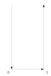

I need help with a textbook exercise (Stein's Complex Analysis, Chapter 3, Exercises 9). This exercise requires me to show that $$\int_0^1 \log(\sin \pi x)dx=-\log2$$ A hint is given as "Use the contour shown in Figure 9."
Since this is an exercise from Chapter 3, I think I should use the residue formula or something like that. But the function $f(x)=\log(\sin \pi x)$ becomes singular on $x=0$ and $x=1$, which makes the contour illegal for the residue theorem. Can anyone give me a further hint on this problem? Many thanks in advance!

Consider $$f(z) = \log(1-e^{2 \pi zi }) = \log(e^{\pi zi}(e^{-\pi zi}-e^{\pi zi})) = \log(-2i) + \pi zi + \log(\sin(\pi z))$$ Then we have \begin{align} \int_0^1 f(z) dz & = \log(-2i) + \dfrac{i \pi}2 + \int_0^1 \log(\sin(\pi z))dz\\ & = \int_0^1 \log(\sin(\pi z))dz + \log(-2i) + \log(i)\\ & = \log(2) + \int_0^1 \log(\sin(\pi z))dz \end{align} Now it suffices to show that $\displaystyle \int_0^1 f(z) dz = 0$. Consider the contour $C(\epsilon,R)$ (which is the contour given in your question) given by the following.
$1$. $C_1(\epsilon,R)$: The vertical line along the imaginary axis from $iR$ to $i \epsilon$.
$2$. $C_2(\epsilon)$: The quarter turn of radius $\epsilon$ about $0$.
$3$. $C_3(\epsilon)$: Along the real axis from $(\epsilon,1-\epsilon)$.
$4$. $C_4(\epsilon)$: The quarter turn of radius $\epsilon$ about $1$.
$5$. $C_5(\epsilon,R)$: The vertical line from $1+i\epsilon$ to $1 + iR$.
$6$. $C_6(R)$: The horizontal line from $1+iR$ to $iR$.
$f(z)$ is analytic inside the contour $C$ and hence $\displaystyle \oint_C f(z) = 0$. This gives us $$\int_{C_1(\epsilon,R)} f dz + \int_{C_2(\epsilon)} f dz + \int_{C_3(\epsilon)} f dz + \int_{C_4(\epsilon)} f dz + \int_{C_5(\epsilon,R)} f dz + \int_{C_6(R)} f dz = 0$$
Now the integral along $1$ cancels with the integral along $5$ due to symmetry. Integrals along $2$ and $4$ scale as $\epsilon \log(\epsilon)$. Integral along $6$ goes to $0$ as $R \to \infty$. This gives us $$\lim_{\epsilon \to 0} \int_{C_3(\epsilon)} f dz = 0$$ which is what we need.
