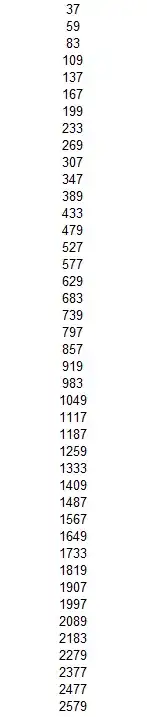

Generating function:
$n^2 + 21n + 37$
First few values are:
Joebloggs
  • 160
