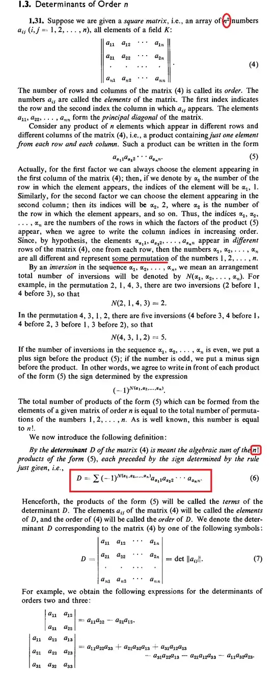

I have been reading chapter 1 of Shilov's Linear Algebra and get stuck at the part where he mentions determinant and permutation:
I just want to ask a couple questions regarding the part that is circled in red.I understand the inversion part, but I don't know how can one determine the formula for n order determinant by using the formula that is circled in red. How does he derive this formula to begin with?

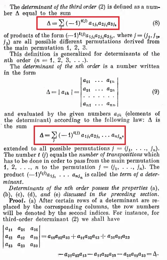

In another Russian book, the determinant is also defined as permutation as well, this image is taken from "Fundamentals of Linear Algebra and Analytical Geometry" by Bugrov and Nikolsky:

Are you confused about the meaning of the $\sum$ sign, as in, what the addends are, or are you confused about the signs?
  • The sum in Shilov's book is a sum over all sequences $\left(\alpha_1, \alpha_2, \ldots, \alpha_n\right)$ that are permutations (i.e., rearrangements) of the sequence $\left(1,2,\ldots,n\right)$. The sum in Bugrov and Nikolsky's book is a similar sum, except that they denote the sequences by $\left(j_1, j_2, \ldots, j_n\right)$ rather than by $\left(\alpha_1, \alpha_2, \ldots, \alpha_n\right)$.
  • The sign in the addend corresponding to a permutation $j$ is a $+$ if $j$ has an even number of inversions, and a $-$ if $j$ has an odd number of inversions.

  • Yeah, in general, I am kind of confused about the sum sign and the rearrangement. How can the determinant be defined as rearrangement. Should I compute determinant of order 2 and 3 to see the pattern? Doesn't the product of the determinant mean the order of each element does not matter? – James Warthington Oct 27 '19 at 23:13
  • The determinant is not a rearrangement; it is a sum over all rearrangements. I suggest you read Strickland's Appendix B, which is more modern and more detailed than most Russian texts. Examples B.8 and B.9 will perhaps answer your question. – darij grinberg Oct 27 '19 at 23:13
