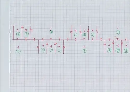

Here is the version from J. H. Conway's book, The Sensual Quadratic Form. What I do is add in the value of the quadratic form at the point in question, here in a color that is supposedly called fuchsia, then draw, as a column vector in green, the point in question. The main theorem is pages 20-23 of the book, the river is periodic. With my extra labelling, you can also see the automorph matrix $A$ at the second occurence of the form $\langle 1,0,-5 \rangle,$ as this $1$ happens at the column vector with entries $(9,4),$ then the $-5$ occurs at the column vector with entries $(20,9).$
Let's see, this is quite visual. It is probably most reasonable to say that the primitive representations of $-4$ have two representatives in each period, here given by $(1,1)$ and then $(11,5).$ In comparison, the representations of $-1$ happen only once per period, $(2,1),$ so the imprimitive representations of $-4$ come from $(4,2).$ For both primitive and imprimitive, all representations then occur using the automorph to jump from one period to the next.
Lagrange's "reduced" forms occur exactly where the value crosses the river, The value in yellow and the little arrow tell you what the equivalent form is: the reduced ones are, only, $\langle 1,4,-1 \rangle,$ and $\langle -1,4,1 \rangle.$ What this says is that the value $-4$ would not be found by continued fractions for $\sqrt 5.$

  • I actually doesn't understand this well. I think that the opposide side of the lines are $\langle α,β,γ \rangle,$ and the automorph is the green numbers so for $\langle 1,0,-5 \rangle,$ we have:

  • But whta those numbers in orange color mean? you have 6 and 10 in vertical lines and 0, 2 and 4 in horizontal. How did you get them and what those mean? And one more question how did you get those numbers in green? – Stefan4024 Mar 26 '13 at 11:49

  • @Stefan4024, I gave a link to a pdf for Conway's book. You will need to read the first chapter only. I drew this myself, then scanned it as a color jpeg, then posted to the site from my home computer. Buell's book is also very good; it is a reference here: http://en.wikipedia.org/wiki/Binary_quadratic_form and linked here http://books.google.com/books?id=qMa8-FDOR8YC&pg=PP1&lpg=PP1&dq=buell+binary+quadratic+forms&source=bl&ots=0I2rM86JSc&sig=Sl2Bud1zk_VjEO16IC4aLJZhbSI&hl=en&sa=X&ei=2edRUebMLKjziwKchoGQAw&ved=0CFwQ6AEwBA – Will Jagy Mar 26 '13 at 18:28
  • I can't understand this. Maybe it's because my lack of knowledge in English or it's maybe too complex for me, I don't know.
    I think it'll be better to show how you generate you example in the picture and explain it. Maybe it'll be clearer to me.
    – Stefan4024 Mar 26 '13 at 22:50
