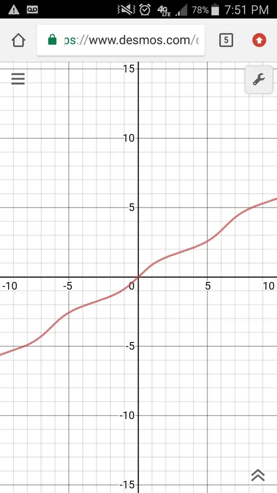

$\mathbf{EDIT}$: In this case, the continuous antiderivative should be of the form:
$$\frac{2}{\sqrt{3}}\tan^{-1}\left(\sqrt{3}\tan\left(\frac{x}{2}\right)\right) + \frac{2\pi}{\sqrt{3}}\Bigr\lfloor \frac{1}{2\pi}x+\frac{1}{2}\Bigr\rfloor + C$$
This function is both continuous and differentiable at its former discontinuities, even though it may not look like it at first glance.
And a graph of the fixed function, courtesy of Desmos:
