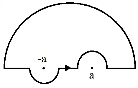

Now, instead of displacing the poles, consider deforming the contour as follows,
Then, $I$ can be obtained by integrating over the above contour (let's call it $C$) and taking the radius $R$ of the large semicircle to $\infty$, and the radii $\epsilon$ of the small semicircles (call them $S_1$ and $S_2$) to $0$. Again, the integral over the big semicircle vanishes, and \begin{align} I&=\int_C-\int_{S_1}-\int_{S_2}\\ &=-\frac{2\pi i}{2a}f(-a)+\pi i\frac{f(-a)}{2a}+\pi i\frac{f(a)}{2a}\\ &=\frac{2\pi i}{2a}\left(\frac{f(a)-f(-a)}{2}\right), \end{align}

You haven't "deformed" your contour, you've simply replaced one contour by another! There's simply no reason the two integrals should be equal.
They'd be equal if the following false version of Cauchy's Theorem were true:
False CT. Suppose $D$ is an open set, $f$ is analytic in $D$, and $C_1$ and $C_2$ are closed contours in $D$. Then $\int_{C_1}f=\int_{C_2}f$.
That's clearly false, for example $D=\Bbb C\setminus\{0\}$, $f(z)=1/z$, $C_1$ the contour $|z|=1$ and $C_2$ the contour $|z-2|=1$.
A correct version of CT is this:
Actual CT. Suppose $D$ is an open set, $f$ is analytic in $D$, and $C_1$ and $C_2$ are closed contours in $D$. If $C_2$ is homotopic to $C_1$ in $D$ then $\int_{C_1}f=\int_{C_2}f$.
The hypothesis there means that there is a continuous family of contours $C_t$ for $1\le t\le 2$ that connects $C_1$ to $C_2$; in other words, in the correct version of the theorem you need to be able to continuously "deform" $C_1$ to $C_2$, a little tiny bit at a time, without ever leaving $D$.
Here, in order to get from the original contour to the one in the picture, continuously, at some point one of the intermediate contours must pass through the point $z=-a$, which says the "deformation" cannot be done within the set where $f(z)/(z^2-a^2)$ is analytic. So the correct version of CT simply doesn't apply.
