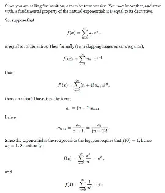

I came across this nice answer on stack:
However, two things still bother me. First, why do we assume a function that equals its own derivative will take the form of $a_nx^n$? Why should it be an exponential function? I can understand the reason for the sigma a little, it implies a function immune to derivatives should work regardless of the input changing from $0$ to infinity (why not negative infinity as well?)
Second, the condition $f(0) = 1$ also bothers me. So assuming we determine the function will be exponential in some way, I'm guessing this is a necessary condition as all exponential will be $1$ when using $0$ as input. Or is there something more to it?

  • We're assuming that there exists some function that admits a power series. – Sean Roberson Oct 14 '19 at 00:58
  • Thanks! How do we make that assumption however? Could there be another function that could equal its own derivative for example, which is not exponential? – SzL Oct 14 '19 at 01:03
  • There could be another function, but that's not part of the assumption. – Sean Roberson Oct 14 '19 at 01:16
    We don't assume it takes the form of $A_nx^n$ which not an exponential function. (An exponential function is $b^x$, not $x^n$). We assume that $f(x)$ takes a form of an infinite* sum of power values. In other words a power series. We can assume this, because if it is its own derivative it is infinitely differentiable and that is just it's Taylor series. – fleablood Oct 14 '19 at 01:26
