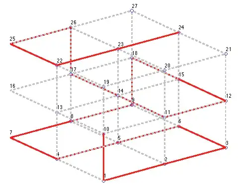

As an attempt to solve the $n=3$ case, I set out to answer a related question: whether the subgraph (let's call it $G_3'$) of $G_3$ whose coordinates are in $\{-1,0,1\}^3$ contains a Hamiltonian ray starting at the origin. Not knowing any better, I settled the issue by brute force in Matlab (see the code below, in which you can change the starting point).
Result: $G_3'$ does not contain a Hamiltonian ray starting at the origin.

  • In $G'_3$ with your labelling: start with $1,2,3,6,5,4,7,8,9$, then continue the next level $18,17,16,13,14,15,12,11,10$, then finish top with $19,20,21,24,23,22,25,26,27.$ I think this visits each node once, and the two vertical junctures from 9 to 18 and from 10 to 19 are OK as unit moves. – coffeemath Mar 24 '13 at 00:09
    Ha! Yes, $G_3'$ does contain a Hamiltonian ray starting at the vertex I labelled by "1". I should have specified that the starting point should be the origin. Sorry -_- I had forgotten that graph $G_3'$ does contain some Hamiltonian rays, if the starting point is chosen wisely. – jub0bs Mar 24 '13 at 00:16
  • For a short proof of your brute-force result, see http://math.stackexchange.com/a/176891. (The proof is suggested in the question, not in the answer :-) – joriki Mar 24 '13 at 05:55
  • @joriki Your description of my "smaller" problem in lay terms is great! However, I fail to see how to solve it. Could you please elaborate in an answer? – jub0bs Mar 24 '13 at 15:10
    @Jubobs: Color the nodes alternately black and white. Say the origin is white, so that the corners are black. There are $13$ white nodes and $14$ black nodes, and any path must alternate colors. You’re starting at a white node, so any path is of the form WBWBWB... and can therefore contain at most $26$ nodes. To hit every node, you must start at a black node. – Brian M. Scott Mar 24 '13 at 18:40
