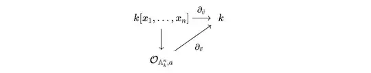

Define the directional derivative at $a$ in the direction $\vec{v}\in k^n$ to be the composite $$ \tag{5}\label{dd} \partial_{\vec{v}}:k[x_1,\dots,x_n] \xrightarrow{(-)|_{a+t\vec{v}}}k[t] \xrightarrow{\frac{d}{dt}}k[t] \xrightarrow{(-)|_{t=0}}k $$ Then $\partial_{\vec{v}}f=\vec{v}\cdot\nabla f(a)$. Moreover, \eqref{dd} is a $k$-derivation (where $k$ has a $k[x_1,\dots,x_n]$-module structure coming from valuation at $(x_1,\dots,x_n)=a$), for the middle morphism in \eqref{dd} is a $k$-derivation and the left and right morphisms are $k$-algebra homomorphisms. By the universal property of the localization with respect to derivations [ref] and since $\mathcal{O}_{\mathbb{A}^n_k,a}=k[x_1,\dots,x_n]_{\mathfrak{m}_p}$, the directional derivative induces a $k$-derivation $\partial_{\vec{v}}:\mathcal{O}_{\mathbb{A}^n_k,a}\to k$ such that the diagram enter image description here commutes. Let $\mathscr{I}_{X,a}\subset\mathcal{O}_{\mathbb{A}^n_k,a}$ be the ideal of germs with a representative that vanish at $X$. Then \begin{align*} T_aX &=\{\vec{v}\in k^n\mid\partial_{\vec{v}}f=0, \;\forall f\in\mathscr{I}(X)\}\\ &=\{\vec{v}\in k^n\mid\partial_{\vec{v}}f=0, \;\forall f\in\mathscr{I}_{X,a}\}.\tag{6}\label{tss} \end{align*} The first equality is identity \eqref{ts}. To see the second equality, note that $\partial_{\vec{v}}(\mathscr{I}_{X,a})=0\Rightarrow \partial_{\vec{v}}(\mathscr{I}(X))=0$ by commutativity of the diagram above. Conversely, suppose $\vec{v}\in k^n$ satisfies $\partial_{\vec{v}}f=0$ for all $f\in\mathscr{I}(X)$. Let $h\in\mathscr{I}_{X,a}$. We may assume $h=f/g$, where $f\in\mathscr{I}(X)$. Then $\displaystyle\partial_{\vec{v}}\left(\frac{f}{g}\right)=\frac{g(a)\partial_{\vec{v}}f-f(a)\partial_{\vec{v}}g}{g(a)^2}=\frac{g(a)\partial_{\vec{v}}f}{g(a)^2}=0$.
Therefore, if $\vec{v}\in T_aX$, then $\partial_{\vec{v}}:\sO_{\A^n_k,a}\to k$ induces a $k$-derivation $\partial_{\vec{v}}:\sO_{X,a}=\sO_{\A^n_k,a}/\mathscr{I}_{X,a}\to k$.
