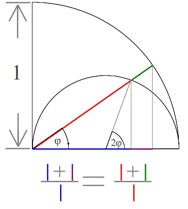

I tried for a few days to prove the identity $\sin(x)\cos(x)=\frac{\sin(2x)}{2}$ and finally got the following proof. I wanted to know if someone knew a simpler or more elegant way to proof it.
$$\begin{align}\dfrac{\cos(\phi)}{\frac{1+\cos(2\phi)}{2}}&=\dfrac{1}{\sqrt{\frac{(1+\cos(2\phi))²+\sin²(2\phi)}{4}}} ~~~~~~~~~~~~~~~*\frac{1+\cos(2\phi)}{2}\\ \cos(\phi) &=\dfrac{\frac{1+\cos(2\phi)}{2}}{\sqrt{\frac{1+2 \cos(2\phi)+ \cos²(2\phi)+sin²(2\phi)}{4}}}\\ \cos(\phi)&=\dfrac{\frac{1+\cos(2\phi)}{2}}{\sqrt{\frac{1+\cos(2\phi)}{2}}}\\ \cos(\phi)&=\sqrt{\frac{1+\cos(2\phi)}{2}}\\ \cos²(\phi)&=\frac{1+\cos(2\phi)}{2}\end{align}$$
$\begin{align}\frac{\sin(\phi)}{\cos(\phi)}&=\dfrac{\frac{\sin(2\phi)}{2}}{\frac{1+\cos(2\phi)}{2}}\\ \frac{\sin(\phi)}{\cos(\phi)}&=\dfrac{\frac{\sin(2\phi)}{2}}{\cos²(\phi)}\\ \sin(\phi)\cos(\phi)&=\frac{\sin(2\phi)}{2}\end{align}$

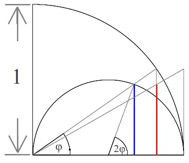

I also tried this:
showing that enter image description here but didn't manage. I would be glad if someone had an idea on this.

  • In OP's diagram, simply connect the (non-origin) end of the red segment to the right end of the horizontal radius of the big circle; this creates a right triangle with legs $\cos\phi$ and $\sin\phi$, hence area $\frac{1}{2}\cos\phi\sin\phi$ on the other hand, the altitude from the right corner to the hypotenuse (the blue vertical segment in OP's second diagram) is $\frac{1}{2}\sin 2\phi$, while the hypotenuse-base is $1$, so that the triangle's area is can also be computed as $\frac{1}{2}\cdot 1 \cdot\frac{1}{2}\sin 2\phi$. – Blue Mar 23 '13 at 03:21
