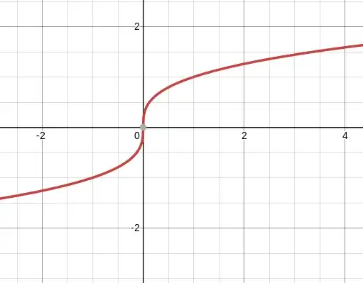

Plotting the function $f(x)=x^{1/3}$ defined for any real number $x$ gives us: plot of function
Since $f$ is a function, for any given $x$ value it maps to a single y value (and not more than one $y$ value, because that would mean it's not a function as it fails the vertical line test). This function also has a vertical tangent at $x=0$.
My question is: how can we have a function that also has a vertical tangent? To get a vertical tangent we need 2 vertical points, which means that we are not working with a "proper" function as it has multiple y values mapping to a single $x$. How is it possible for a "proper" function to have a vertical tangent?
As I understand, in the graph I pasted we cannot take the derivative of x=0 because the slope is vertical, hence we cannot see the instantaneous rate of change of x to y as the y value is not a value (or many values, which ever way you want to look at it). How is it possible to have a perfectly vertical slope on a function? In this case I can imagine a very steep curve at 0.... but vertical?!? I can't wrap my mind around it. How can we get a vertical slope on a non vertical function?

    Funny that you mention this, because I recall, back in the day, being very upset with $f'(x)$ being the slope of the tangent line, since in most cases this so-called "tangent line" used to intersect the curve plenty of times, as opposed to just $1$. –  Oct 05 '19 at 18:08
    "In this case I can imagine a very steep curve at 0.... but vertical?!? I can't wrap my mind around it. How can we get a vertical slope on a non vertical function?" What do you think the slope of the tangent line at that point should be? – Noah Schweber Oct 05 '19 at 18:25
  • @NoahSchweber What should it be? My thoughts were/are as follows: say one secant point is at (0,0) and another point is moving closer and closer to it (from either side, doesn't matter). The points can get infinitely close, yet the slope of the secant line would never get vertical. So to answer your question - very steep but less than 90 degrees :-)... but obviously I am wrong, I just haven't conceptually grasped where my thinking is wrong – Mike Oct 06 '19 at 01:35
  • 28
    Rotate the graph through 90 degrees, and consider $f(x) = x^3$. Do you have a problem with the idea that the tangent line at $x = 0$ is horizontal? – alephzero Oct 06 '19 at 14:21
  • 25
    " To get a vertical tangent we need 2 vertical points". This certainly NOT true. I don't know where you tot that idea. That is true or a vertical graph, not of a vertical tangent to the graph. – user247327 Oct 06 '19 at 15:20
  • 13
    A vertical secant requires two points on the same vertical line... – Eric Towers Oct 06 '19 at 16:43
  • @alephzero: to be pedantic, that rotation yields the graph of $f(x)=-x^3$. – Greg Martin Oct 07 '19 at 04:44
    Youve used a vertical tangent line to the function- as the definition of vertical line test which is incorrect. Typical incorrect recall of concretely defined terms, not sure why +16? – marshal craft Oct 07 '19 at 10:13
  • It's as simple as this, you cannot make a vertical line from two points on that graph. – marshal craft Oct 07 '19 at 10:16
    Definition of a tangent is that it touches at one point (locally). Where did the two point idea come from? – Apollys supports Monica Oct 07 '19 at 21:26

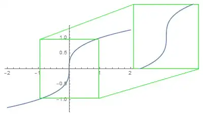

The tangent line is simply an ideal picture of what you would expect to see if you zoom in around the point.
$\hspace{8em}$ Tangent line
Hence, the vertical tangent line to the graph $y = \sqrt[3]{x}$ at $(0,0)$ says nothing more than that the graph would look steeper and steeper as we zoom in further around $(0, 0)$.
We can also learn several things from this geometric intuition.
1. The line is never required to pass through two distinct points, as the idea of a tangent line itself does not impose such an extraneous condition.
For instance, tangent lines pass through a single point even in many classical examples such as conic sections. On the other extreme, a tangent line can pass through infinitely many points of the original curve as in the example of the graph $y = \sin x$.
2. Tangent line is purely a geometric notion, hence it should not depend on the coordinate system being used.
On the contrary, identifying the curve as the graph of some function $f$ and differentiating it does depend on the coordinates system. In particular, it is not essential for $f$ to be differentiable in order to discuss a tangent line to the graph $y = f(x)$, although it is a sufficient condition.
OP's example serves as a perfect showcase of this. Differentiating the function $f(x) = \sqrt[3]{x}$ fails to detect the tangent line at $(0,0)$, since it is not differentiable at this point. On the other hand, it perfectly makes sense to discuss the vertical tangent line to the curve
$$ \mathcal{C} = \{(x, \sqrt[3]{x}) :x \in \mathbb{R} \} = \{(y^3, y) : y \in \mathbb{R} \}, $$
and indeed the line $x = 0$ is the tangent line to $\mathcal{C}$ at $(0, 0)$.
