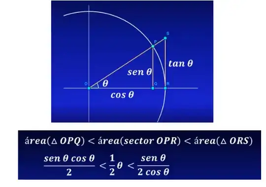

    You cannot use L'H since the derivative requires knowing the limit. – Andrew Chin Oct 02 '19 at 23:06
  • The typical proof is geometric and uses the squeeze theorem. – Andrew Chin Oct 02 '19 at 23:06
  • An elementary and acceptable proof is considering a point P on the unit circle in the first quadrant, along with it a triangle inside and outside the circle. Considering areas as P moves to the x axis results in the limit. I am sure this can be found somewhere on MSE. I am glad though you see that Hospital is not the way to go. – imranfat Oct 02 '19 at 23:09

COMMENT.-In the circle of radius $1$ take the figure above and go to the limit.
