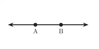

Let us systematically generate all constructible points in the plane. We begin with just two points, which specify the unit distance.

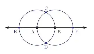

With the straightedge, we may construct the line joining them. And with the compass, we may construct the two circles centered at each of them, having that unit segment as radius. These circles intersect each other and the line, creating four additional points of intersection. Thus, we have now six points in all.

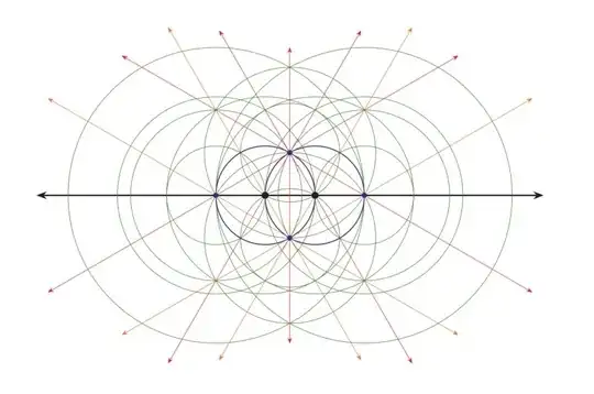

Using these six points, we proceed to the next stage, constructing all possible lines and circles using those six points, and finding the resulting points of intersection.
I believe that we now have 203 points. Let us proceed in this way to systematically construct all constructible points in the plane, in a hierarchy of finite stages. At each stage, we form all possible lines and circles that may be formed from our current points using straightedge and compass, and then we find all points of intersection from the resulting figures.

  • It might help if people double-check the 203 number, since it is easy to miscount, and also help verify that the figure indeed shows all the relevant lines and circles. – JDH Oct 02 '19 at 13:20
    I used Mathematica to check your numbers and can confirm 203 points at third stage. But couldn't find the fourth stage with the same code, it takes too much time. – Intelligenti pauca Oct 03 '19 at 10:18

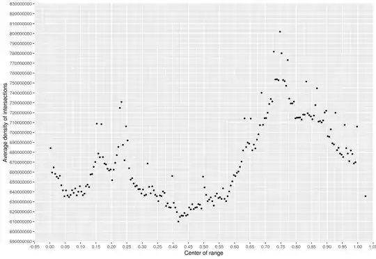

I have found the fourth number in the constructibility sequence: $$1723816861$$ I computed this by splitting the first quadrant into sections along the x-axis, computing values in these sections and combining them. The program was not parallel, but the work was split amongst 6 process on 3 machines. It took approximately 6 days to complete and each process never used more than 5GB of RAM.
My data can be found here. I've produced these two graphs from my data, which give a sense of how the points are distributed: enter image description here If we focus at the area from $0$ to $1$ we get: enter image description here
