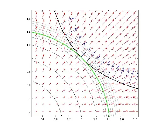

Suppose I want to maximise $f(x,y)=x^2 y$ subject to constraint $g(x,y)=x^2 + y^2 = 1$.
Geometrically, we can say that from a contour plot, $f$ is maximised under the constraint at the point where the level of $f$ is tangential to $x^2+y^2=1$. This would look something like this: contour plot
We'll call the position of the tangent, where the thick black line meets the thick green line, $(x_m,y_m)$.
What can be observed is that the gradient of $f$ at this point and the gradient of $g$ at this point, are proportional. Hence, we introduce the Lagrange multiplier, $\lambda$, a constant of proportionality for this relation:
$$\nabla f(x_m,y_m) = \lambda \nabla g(x_m,y_m)$$
From this we get a system of equations and solve for the maximum.
Now that was fine, and the idea of $\nabla f$ being proportional to $\nabla g$ is easy to see, with thanks to the geometric interpretation. Where I become confused is when we start adding multiple constraints.
