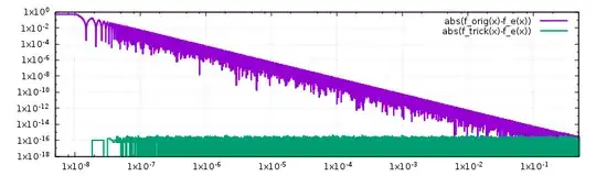

The equivalent expressions $2\left(\frac{\sin(x/2)}{x}\right)^2=\frac1{1+\cos x}\left(\frac{\sin x}x\right)^2$ are evaluated exactly within the capabilities of the floating point format and thus can serve as the exact values $f_e(x)$. Comparing the two expressions $f_{\rm orig}(x)$ and $f_{\rm trick}(x)$ in question against these gives the plot
error plot
This confirmes the claimed difference in the floating point results.
Why does that happen? Clearly the floating point evaluation of $1-\cos(x)$ leads to catastrophic cancellation for $x\approx 0$, with $$ 1-\frac12x^2\le \cos x\le 1-\frac12x^2+\frac1{24}x^4. $$ The error will be of the scale $\delta=2^{-54}=5.55\cdot 10^{-17}$ independent of how small or large $x$ is. \begin{array}{ll} x&fl(1-fl(\cos x))-2\cdot fl(\sin(x/2))^2\\ \hline 0.0123 & -3.06558e{-}17\\ 0.00123 & -2.63537e{-}17\\ 0.000123& +3.59060e{-}17\\ 1.23e{-}05& +4.57838e{-}17\\ 1.23e{-}06& -5.50533e{-}17\\ 1.23e{-}07& -1.49834e{-}17\\ 1.23e{-}08& +3.53773e{-}17\\ 1.23e{-}09& -7.56450e{-}19\\ \end{array} where $fl(y)$ indicates floating point rounding of the argument. Then with $c_x=fl(\cos x)$ and $\bar x=fl(\arccos c_x)$ a value is computed that is in the center of the interval with $$ fl(\cos(u))=c_x\iff \cos(u)\in[c_x-\delta,c_x+\delta]. $$ With $\cos(u)-\cos(\bar x)=-2\sin(\frac{u-\bar x}2)\sin(\frac{u+\bar x}2)\approx -\bar x(u-\bar x)$ we get $|\bar x|\,|u-\bar x|\lesssim δ$.
The value $\frac{1-c_x}{\arccos(c_x)^2}=\frac{1-\cos\bar x}{\bar x^2}$ is now exact at the modified point $\bar x$, and the error is about $f'(\bar x)(x-\bar x)=\frac{\bar x}{12}(x-\bar x)\lesssim\fracδ{12}$ (using the derivative of $f(x)=\frac12-\frac1{24}x^2+\frac1{6!}x^4+...)$). This is below the relative precision at the result at $\approx \frac12$.
The observed error in the second formula to the reference formula is the floating point error of the remaining operations in $\frac{1-c_x}{\bar x^2}$.
