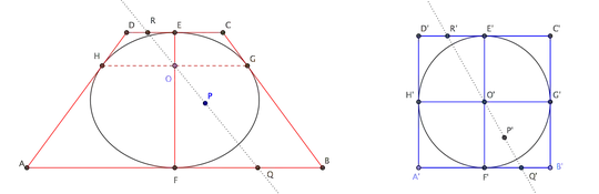

If point $O$ is to be mapped to the centre of the circle, let $EF$ be the diameter of the ellipse through $O$. Draw tangents $AB$, $CD$ through $F$ and $E$ and draw $GH$ through $O$ parallel to both tangents. Draw then tangents $BC$, $DA$ through $G$ and $H$. There is a homography mapping the ellipse to the circle, point $O$ to the center $O'$ of the circle and trapezoid $ABCD$ to square $A'B'C'D'$.
To find the transformed of a point $P$ inside the ellipse, you can exploit the invariance of cross-ratios in a homography. For instance, draw line $OP$ intersecting two opposite sides of the trapezoid at $R$ and $Q$. From $(A,B;F,Q)=(A',B';F',Q')$ you can find $Q'$ and then from $(R,Q;O,P)=(R',Q';O',P')$ you can find $P'$.
As this is a linear transformation (in homogeneous coordinates) you can also find a transformation matrix from four couples of corresponding points (e.g. points $EFGH$ and $E'F'G'H'$).
