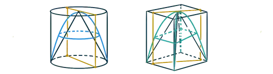

But let's instead start with a base of some other (convex?) shape. You can still build the cylinder over the base by crossing it with $[0,h]$ for some height $h$, and you can still build the cone over this by taking a point in the center of one of the bases of the cylinder as the apex of the cone, and constructing the locus of all lines connecting a point in the other base to that apex. But is there a canonical way to construct the analogue of the ellipsoid in this general situation? Here's an image of what I'm thinking in the case of a square-based cylinder and cone.
The only requirements I can think of for this generalized ellipsoid would be that it needs cross-sections all similar to the base, and it needs to have the correct ratio with the other two volumes, 1 : 2 : 3. And I suppose it should have some relation to the fact that a usual ellipse is the solution set to a quadratic polynomial. But I don't see an obvious (unique) way to do this. And it would be nice if this construction generalized to higher dimensions.

  • @EthanBolker What I'm observing from your hint is that those slices of this shape would still have to be elliptical. I.e. that the way the three nested solids intersect yellow slices I just drew on the image would be "the same" up to rescaling and stuff. – Mike Pierce Apr 25 '22 at 20:49
  • @MikePierce Yes, I think that's right. – Ethan Bolker Apr 25 '22 at 21:05
    So the cross-section would still be an ellipse in every horizontal (vertical?) yellow slice. Okay :) Now the only question is if such a shape has a name – Mike Pierce Apr 25 '22 at 23:25
