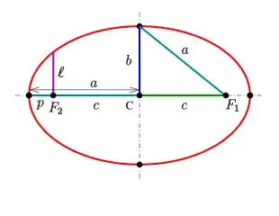

Here are some of the specific measurements of the ellipse and the relationships among them. Let \begin{align} a &= \text{length of semimajor axis},\\ b &= \text{length of semiminor axis},\\ c &= \text{distance from center to focus},\\ e &= \text{eccentricity},\\ \ell &= \text{length of semilatus rectum},\\ p &= \text{distance from focus to the nearest vertex}, \end{align} as in this figure adapated from https://en.wikipedia.org/wiki/File:Ellipse-param.svg:
figure of ellipse with dimensions labeled
(I relabeled parts of the figure to match the equations above, which follow some common conventions for labeling parts of an ellipse or parabola.)
The eccentricity is not labeled, but is it given by the formula $$ e = \frac ca. \tag1 $$
Other relationships among the parameters are \begin{align} a^2 &= b^2 + c^2, \tag2\\ \ell &= \frac {b^2}{a}, \tag3\\ p &= a - c. \tag4 \end{align}
From $(1)$, we get $c = ae,$ so $$ p = a - ae = a(1 - e). $$ Therefore if we hold $p$ constant but allow $e$ to vary, $$ a = \frac{p}{1 - e}$$ and $$ c = ae = p\frac{e}{1 - e}, $$ so $a$ and $c$ both go to infinity as $e$ approaches $1.$
From $(2)$, we have $$b^2 = a^2 - c^2 = (a-c)(a+c) = p(a+ae) = p^2\frac{1+e}{1 - e},\tag5$$ which implies that as $e$ goes to $1,$ $b^2$ goes to infinity, and therefore so does $b$. And that's how the semimajor axis depends on $e$ when you hold $p$ constant.
Plugging $(5)$ into $(3)$, $$\ell = \frac {p(a+c)}{a} = p\left(1 + \frac ca\right) = p(1+e),$$ so as $e$ approaches $1,$ $\ell$ approaches $2p,$ which is the semilatus rectum of a parabola where the distance from the focus to the vertex is $p.$

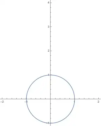

Fixing the minor axis is problematic for visualizing the phenomenon at hand, since an ellipse's minor axis is finite, while a parabola's is not. @robjohn's animation, duplicated here,
fixes an element that remains finite throughout: the focus-to-vertex distance.
Another good element to fix is the latus rectum (the focal chord perpendicular to the major axis):
As with @robjohn's animation, one focus remains at the origin while the other scoots off to infinity.
A nice thing about this family is that it's generated by a simple polar equation $$r = \frac{\ell}{1-e\sin\theta}$$ (with $\ell$ the semi-latus rectum) where the animation varies eccentricity $e$ from $0$ (the circle) to $1$ (the parabola). (Taking $e$ beyond $1$ brings hyperbolas into the picture. In that context, one might well convince oneself that the ellipse's focus didn't just go off to infinity to give the parabola, it came back from the other side of the universe to give the hyperbolas.)
