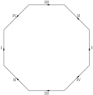

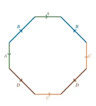

The answer to this question shows two different fundamental polygons to represent a double torus, i.e.
Let's call $I=A,II=B,III=C$ and $IV=D$, start from left and go counter-clockwise, then their identifications of their sides are:
  • left: $\,\,\,A\phantom{^{-1}}D^{-1}C^{-1}B^{-1}A^{-1}D\phantom{^{-1}}C\phantom{^{-1}}B\phantom{^{-1}}$
  • right: $A^{-1}B\phantom{^{-1}}A\phantom{^{-1}}B^{-1}C^{-1}D\phantom{^{-1}}C\phantom{^{-1}}D^{-1}$
What's difference between them? Are there more $8$-sided fundamental polygons for the double torus?

The right-hand one emphasizes the double torus (I prefer "genus two surface") as a Connected Sum of two (one-holed) tori. The left hand one emphasizes the genus two surface as a Translation surface. From the perspective of topology, the surfaces are identical, but their construction differs. Not all ways of labeling the sides of the octagon will give you a genus-two surface. $A^2B^2C^2D^2$ will give you something nonorientable. I would conjecture that any way of writing an 8-letter word in $A,B,C,D$ and their inverses such that each letter appears once positive and once negative and no label is next to its inverse will work, but I don't have a proof.
However, the theory of translation surfaces suggests that there are infinitely many ways to glue the sides of a polygon to produce a genus-two surface.
